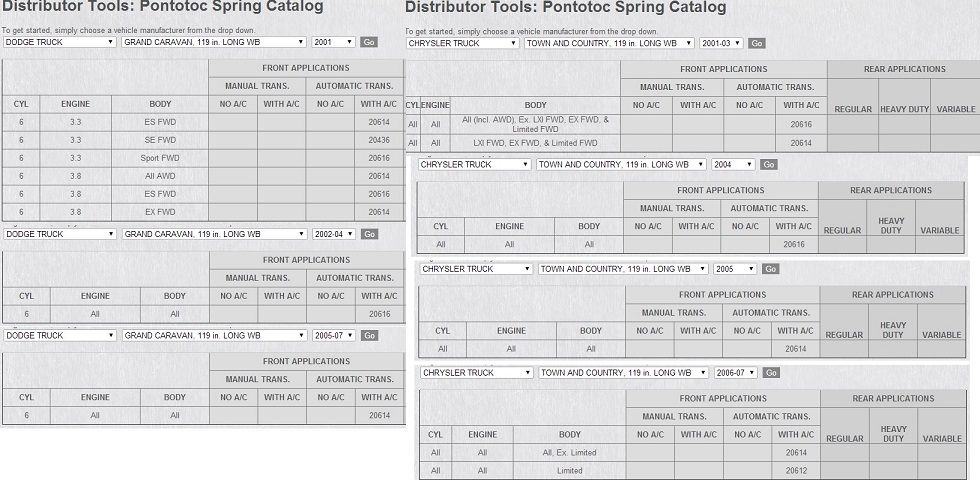

The Pontotoc catalog lists 3 springs for the 4th gen, one of them is specifically for the SWB
http://www.mw-ind.com/distributor-tools-pontotoc-spring-catalog
An excerpt is below.
The Pontotoc interchange website is interesting since it appears Pontotoc makes the springs for NAPA, AC/DELCO,Rockwell (Husky Spring), and Moog, (this may include Raybestos as well)
http://www.mw-ind.com/distributor-tools-pontotoc-part-number-interchange
We can obtain some technical info on the springs from the NAPA website doing a reverse lookup:
Part Number: NCP 2773404 (Pontotoc 20436)
Product Line: NAPA Chassis Parts
Attributes:
Coil Spring Free Height : 14.96" Driver Side/13.97" Pass. Side
Coil Spring I.D. : 5.50"
Coil Spring Load Height : 7"
Coil Spring Type : 1 Square End; 1 Pigtail End
Design Load : 1114 Driver Side/975 Pass. Side
Spring Rate : 140
Wire Diameter : .58"
Important Information:
w/ 113.3" Wheelbase
Part Number: NCP 2773509 (Pontotoc 20612)
Attributes:
Coil Spring Free Height : Driver Side 16.5" / Pass. Side 15.71"
Coil Spring I.D. : Driver Side 5.58" / Pass. Side 5.58"
Coil Spring Load Height : Driver Side 7" / Pass. Side 7"
Coil Spring Type : 2 Pigtail Ends
Design Load : Driver Side 1330 / Pass. Side 1220
Spring Rate : Driver Side 140 / Pass. Side 140
Wire Diameter : Driver Side .58" / Pass. Side .58"
w/ 119" Wheelbase
Part Number: NCP 2773510 (Pontotoc 20614)
Attributes:
Coil Spring Free Height : Driver Side 16.5" / Pass. Side 14.96"
Design Load : Driver Side 1330 / Pass. Side 0.0
w/ 119" Wheelbase
Part Number: NCP 2773511 (Pontotoc 20616)
Attributes:
Coil Spring Free Height : Driver Side 15.71" / Pass. Side 14.96"
Design Load : Driver Side 1220 / Pass. Side 0.0
